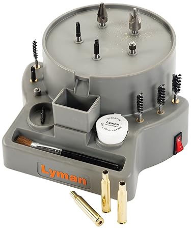

I always keep my brands of brass separate, finished up recapping some SSA brass and started in on the Hornady. The primers were going in a bit difficult and after about four or five they were sheering the caps and leaving a burr from the cap sticking out. So I take apart my capping tool clean and inspect everything, put it all back together, figuring maybe some grime of one sort or another may have accumulated and sent something askew. Try to cap another shell and it is a no go, WTF!!!!! I get out my optivisor and look closely at the primer pocket and realize it has a crimp, WTF!!!!!! I have never seen this in over the counter commercial loads. I bought a chamfering tool and I'm back in business with a little extra pain in the ass to deal with, chamfering about three hundred pieces of brass. Anyone ever heard of that?
