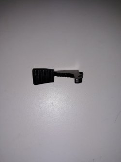

I also wanted a side charging upper because my thermal sits to far back, to use the charging handle easily.
So I went with one that got good reviews. Did I mention this was going to be a dedicated thermal coyote killer, lol
Spartan Side Charge Non-Reciprocating Billet Upper
