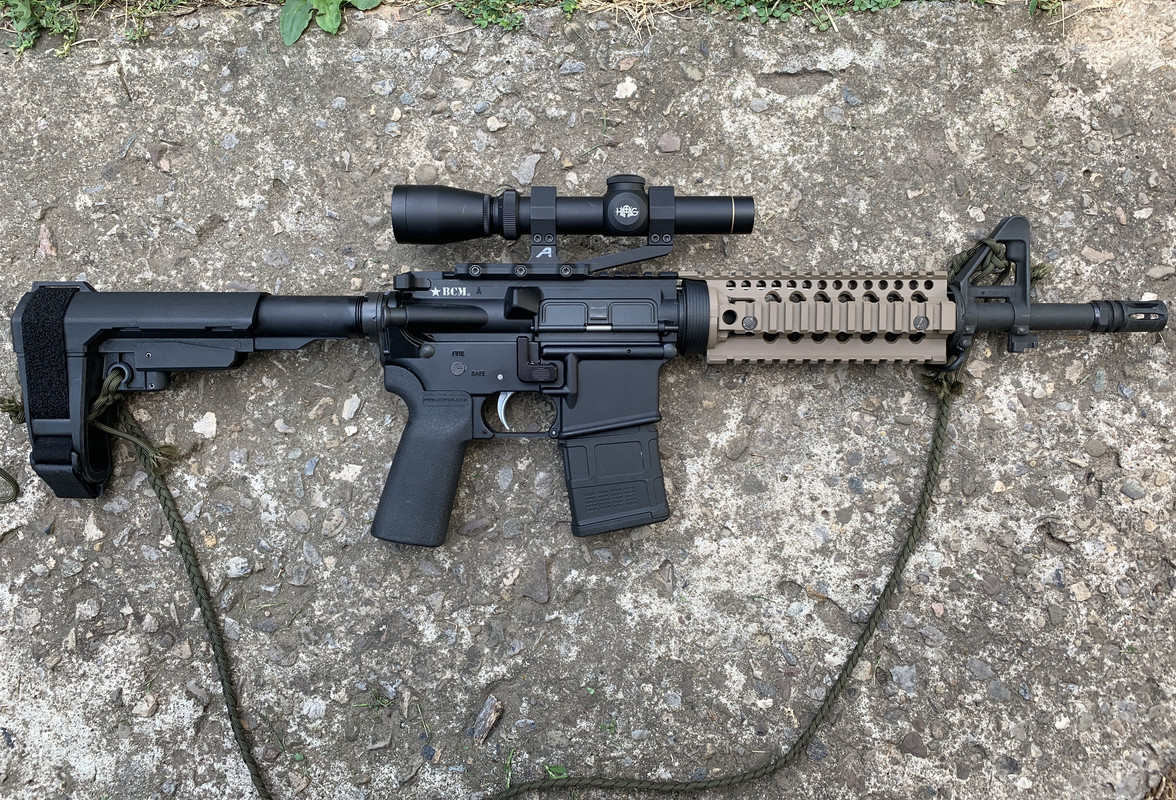

I have successfully hunted whitetail with .223 for the past 5 years. All the deer I have taken have been with a 70gr Barnes tsx bullet out of an 11.5” BCM AR Pistol. I have no reason to doubt the round I’m using, however thought I would shoot a few different weighted bullets to see what kind of expansion I’m getting. The results are as followed..
