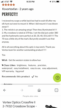

I think it’s the only one they make but just in case this is the cession I’m speaking of. I’d like to get a better one for this coming season. Thoughts? Other suggestions?

I’ve read many reviews and one or two articles that say you set the arrow speed and everything just lines up. They have bullet drop compensators some why not arrow drop compensators?? I know some scopes you can get different reticles for different bullets and weights. Maybe they found a way to make this one changeable on the fly since crossbow speeds aren’t super different these days. I don’t know. I looked on vortex site and there wasn’t much in there other than reviews claiming this. You’d think that would be a huge selling point if this were the case.
