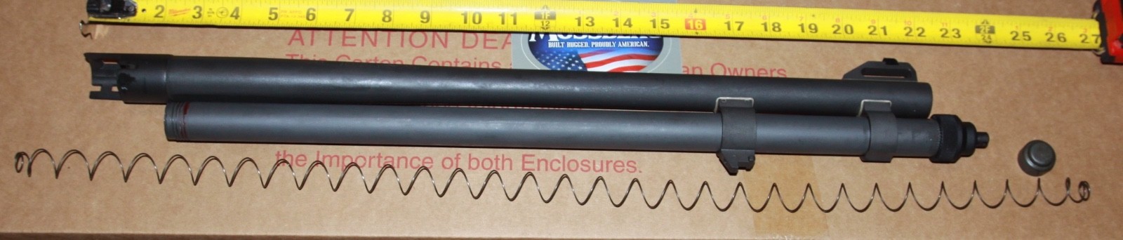

590A1 barrel and mag tube arrived today! Wasted no time installing it. It was kind of a bear to get on. The barrel is thicker walled than my original and I couldn't put the barrel on with the mag tube in place. It just wouldn't line up. I had to put the bolt back in, then insert the barrel, then line up the pump, then slide the mag tube and spring through. Also hadn't realized they red Loctited the mag tube so I had to use the heat gun on it. It's a whole new gun and I'm digging it. The barrel heat shield will need some fitting. I have to find nuts for the screws so that I can clamp it down around the barrel.
